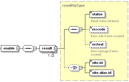

Response Packet Structure
The disable node of the output XML packet is structured as follows:
image 35055
  • The result node is required. It wraps the response from the server. Data type: resultOpType (dns_output.xsd).
  • The status node is required. It specifies the execution status of the disable operation. Data type: string. Allowed values: ok | error.
  • The errcode node is optional. It is used to return the error code when the disable operation fails. Data type: unsignedInt.
  • The errtext node is optional. It is used to return the error message if the disable operation fails. Data type: string.
  • The site-id node is optional. It is required if the site ID was set as a filtering rule in the response packet . Specifies the ID of the site, which zone will use local DNS. Data type: integer.
  • The site-alias-id node is optional. It is required if the site ID was set as a filtering rule in the response packet . Specifies the ID of the site alias, which zone will use local DNS. Data type: integer.
