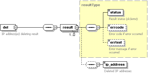

Response Packet Structure
The del node of the output XML packet is structured as follows:
image 35445
  • The result node is required. It wraps the response retrieved from the server. Data type: resultType (common.xsd).
  • The status node is required. It specifies the execution status of the del operation. Data type: string. Allowed values: ok | error.
  • The errcode node is optional. Is returns the error code if the del operation fails. Data type: integer.
  • The errtext node is optional. It returns the error message if the del operation fails. Data type: string.
  • The id_address node is optional. It returns the removed IP address. Data type: ip_address (common.xsd).
