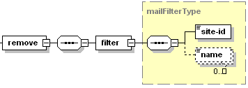

The remove node does not have a separate type, it is nested within the MailTypeRequest type (mail_input.xsd). The remove node has the following graphics representation:
image 34522
  • The filter node is required. It specifies what mail accounts should be removed. Data type: mailFilterType (mail_input.xsd).
  • The site-id node is required. It specifies the identifier of the site which mail account (or several) will be deleted. Data type: integer.
  • The name node is optional. It specifies the name of the mail account to be deleted. Data type: string.
Remarks
To remove all mail accounts existing on a site, include to your request packet filter rule containing only site-id node.

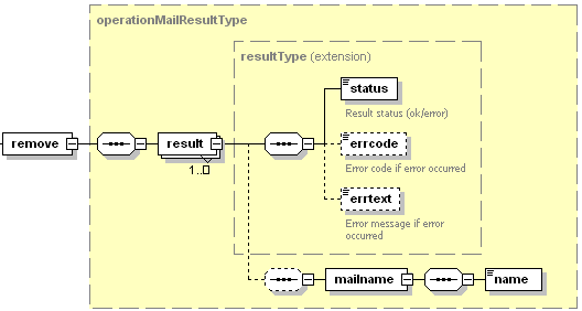

The remove node of the response packet is structured as follows:
image 66748
  • The result node is optional. It wraps the result of the requested remove operation. Data type: resultType (common.xsd).
  • The status node is required. It returns the execution status of the del operation. Data type: string. Allowed values: ok | error.
  • The errcode node is optional. Returns an error code when the remove operation fails. Data type: unsignedInt.
  • The errtext node is optional. Returns an error message if the remove operation fails. Data type: string.
  • The mailname node is optional. It is required if the operation succeeds. Returns a list of updated mail accounts. Data type: complex (mail_output.xsd).
  • The name node is optional. It contains a mail account name. Data type: string.
