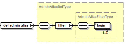

The del-admin-alias node is presented by the complex type AdminAliasDelType (plesk_server.xsd) and structured as follows:
image 75900
  • The filter node is required. It specifies the filtering rule. Data type: AdminAliasFilterType (plesk_server.xsd). This node contains the following nodes:
    • The login node is required. It specifies the login of an additional administrator. Data type: string. This node can be used several times for editing multiple accounts.

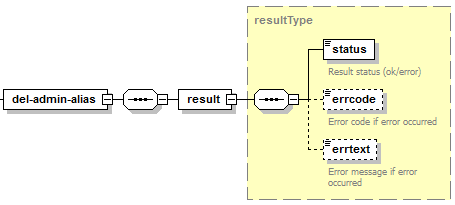

The del-admin-alias node of the response packet is structured as follows:
image 75904
  • The result node is required. It wraps the result of the del-admin-alias operation. Data type: resultType (common.xsd). This node contains the following nodes:
    • The status node is required. It returns the execution status of the operation. Data type: result_status. Allowed values: ok | error.
    • The errcode node is required if the operation fails. Returns error code. Data type: unsignedInt.
    • The errtext node is is required if the operation fails. Returns error message. Data type: string.
