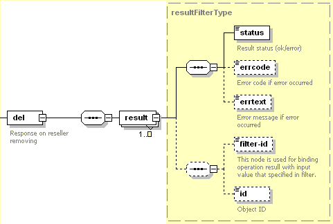

Response Packet Structure
The del node of the response packet is structured as follows:
- The result node is required. It wraps the response retrieved
from the server. Data type: resultFilterType (
common.xsd
).- The status node is required. It specifies the execution
status of the del operation. Data type: result_status
common.xsd
). Allowed values:ok|error
. - The errcode node is required if the del operation fails. It returns the error code. Data type: unsignedInt.
- The errtext node is required if the del operation fails. It returns the error message. Data type: string.
- The filter-id node is required. It returns the parameter by which the reseller account was filtered in the request packet. Data type: anySimple.
- The id node is required if the operation succeeds, or if the
results are filtered by ID. It returns ID of the removed reseller
account. Data type: id_type (
common.xsd
