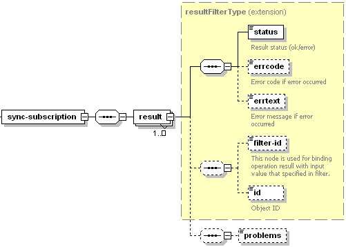

Response Packet Structure
The sync-subscription node of the output XML packet is structured as follows:
image 66404
  • The result node is required. It wraps the response retrieved from the server. Data type: ResultFilterType (plesk_common.xsd).
  • The status node is required. It specifies the execution status of the operation. Data type: string. Allowed values: ok | error.
  • The errcode node is optional. It is used to return the error code when the operation fails. Data type: unsignedInt.
  • The errtext node is optional. Can be used to return the error message if the operation fails. Data type: string.
  • The filter-id node is optional. It is required if the operation succeeds. Returns a filtering rule. For info on filters, refer to the Available Filters section. Data type: anySimple.
  • The id node is optional. It is required if the operation succeeds. Returns a reseller account ID. Data type: integer.
  • The problems node is optional. It outputs conflicts that occur on performing the operation. Data type: string.
