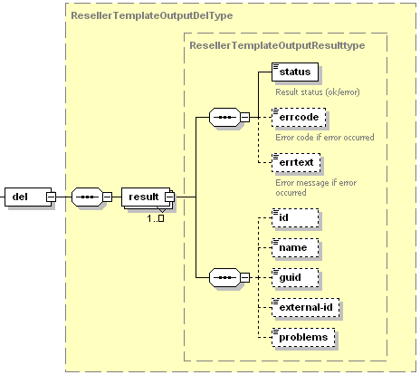

Response Packet Structure
The del node of the response packet is structured as follows:
image 60490
  • The result node is required. It wraps the response retrieved from the server. Data type: ResellerTemplateOutputResulttype (reseller_template.xsd).
    • The status node is required. It specifies the execution status of the del operation. Data type: result_status (common.xsd). Allowed values: ok|error.
    • The errcode node is required if the del operation fails. It returns the error code. Data type: unsignedInt.
    • The errtext node is required if the del operation fails. It returns the error message. Data type: string.
    • The id node is required if the del operation succeeds, and reseller plans are filtered by ID. It returns ID of the removed reseller plan. Data type: id_type (common.xsd).
    • The name node is required if the del operation succeeds, and reseller plans are filtered by name. It returns a name of the removed reseller plan. Data type: string.
    • The guid node is required if the del operation succeeds, and reseller plans are filtered by GUID. It returns a name of the removed reseller plan. Data type: string.
    • The external-id node is required if the del operation succeeds, and reseller plans are filtered by ID in the Panel components. It returns a name of the removed reseller plan. Data type: string.
    •  The problems node is optional. It contains the description of problems occurred on the operation execution. Data type: string.
