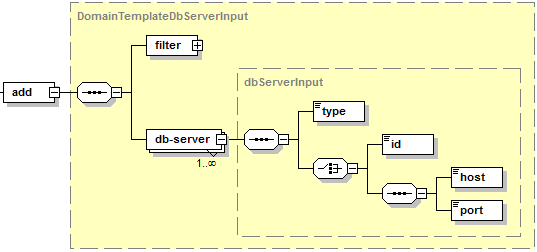

The add node is presented by type DomainTemplateDbServerInput (domain_template.xsd). Its graphical representation is as follows:
image 72622
  • The filter node is required. It serves to specify the criteria by which the necessary service plans will be selected from the database. Data type: DomainTemplateFilterType (domain_template.xsd). See the Available Filters section for details on this node.
  • The db-server node is required. It specifies the database server that will be added to the list of available database servers. Data type: dbServerInput.
  • The type node is required. It specifies the type of the database server. Data type: string.
  • The id node is optional. It specifies the ID of the database server. Data type: string.
  • The host node is optional. It specifies the host name of the database server. Data type: string.
  • The port node is optional. It specifies the port on which the database server is available. Data type: string.
Note
When creating request packets, put nodes and elements in the order they follow in the packet structure.

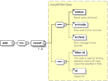

Response Packet Structure
The add node of the output XML packet is of complex type (domain_template.xsd) which has the following presentation:
image 72623
  • The result node is required. It wraps the response got from the server. Data type: resultFilterType (common.xsd).
  • The status node is required. Specifies the execution status of the operation. Data type: string. Allowed values: ok | error.
  • The errcode node is optional. Returns the error code when the operation fails. Data type: unsignedInt.
  • The errtext node is optional. Returns the error message if the operation fails. Data type: string.
  • The filter-id node is optional. Returns the parameter by which the service plan was filtered by in the request packet. Data type: anySimple.
  • The id node is optional. Returns the identifier of the service plan to which the application was added. Data type: id_type (common.xsd).
