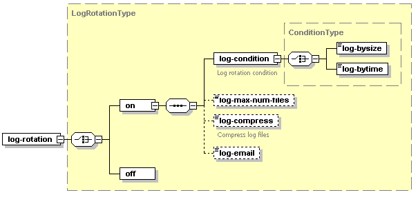

Log rotation settings are specified in the log-rotation node defined by complex type LogRotationType (domain_template.xsd). It is structured as follows:
image 32897
  • The off node is required if the on node is not specified. This node disables log rotation on a subscription created using this service plan. Data type: none.
  • The on node is required if the off node is not specified. This node enables log rotation on a subscription created using this service plan. Data type: none.
  • The log-condition type is required if the on node is specified. Specifies the criterion for triggering log rotation on a subscription. Data type: none.
  • The log-bysize type is required if the on node is specified and the log-bytime node is not. Indicates that log files should be handled once the specified size (in Kb) is achieved. Data type: integer.
  • The log-bytime type is required if the on node is specified and the log-bysize node is not. Indicates that log files should be handled periodically. Data type: string. Allowed values: Daily | Weekly | Monthly.
  • The log-max-num-files node is optional. Specifies the maximal number of handled log files belonging to the subscription that can be stored on the server. Data type: integer.
  • The log-compress node is optional. Enables/disables log file compression. Data type: Boolean.
  • The log-email node is optional. Specifies the email address to which the handled log file can be sent. Data type: string.
