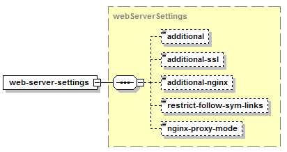

Custom web server settings that are applied to all plan subscriptions
are defined by the web-server-settings node. This node is specified
by complex type webServerSettings (domain_template.xsd) . This
type is structured as follows:
