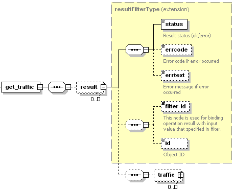

Response Packet Structure
The get_traffic node of the response packet is structured as follows:
image 66630
Note
  • result, optional
    It wraps the result of the requested get_traffic operation. It can be missing if some error occurs before the validation starts. Data type: resultFilterType (common.xsd).
  • status, required
    It returns the execution status of the get_traffic operation. Data type: string. Allowed values: ok | error.
  • errcode, optional
    It is used to return an error code if the get_traffic operation fails. Data type: unsignedInt.
  • errtext, optional
    Can be used to return an error message if the get_traffic operation fails. Data type: string.
  • filter-id, optional
    It is always present and used to return the parameter by which the site was filtered by in the request packet. Data type: anySimple.
  • id, optional
    Returns the identifier of the site whose traffic is requested. It is missing if the request packet fails before the validation on the server side. Data type: integer.
  • traffic, optional
    It contains a collection of traffic data obtained from Plesk server (see below). Data type: trafficType (plesk_domain.xsd).

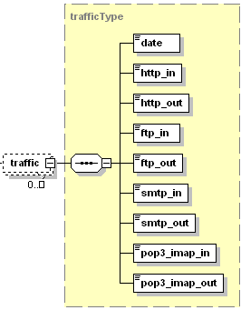

The traffic node is defined by type trafficType (plesk_domain.xsd). It is structured as follows:
image 66631
  • The date, required
    It specifies the date for which the traffic is shown. Data type: date. Format: YYYY-MM-DD.
  • The http_in, required
    It shows the incoming traffic (in bytes) got via HTTP protocol. Data type: integer.
  • The http_out, required
    It shows the outgoing HTTP traffic (in bytes). Data type: integer.
  • The ftp_in, required
    It shows the incoming traffic (in bytes) got via FTP protocol. Data type: integer.
  • The ftp_out, required
    It shows the outgoing FTP traffic (in bytes). Data type: integer.
  • The smtp_in, required
    It shows the incoming traffic (in bytes) got via SMTP protocol. Data type: integer.
  • The smtp_out, required
    It shows the outgoing SMTP traffic (in bytes). Data type: integer.
  • The pop3_imap_in, required
    It shows the incoming traffic (in bytes) got via POP3 and IMAP protocols. Data type: integer.
  • The pop3_imap_out, required
    It shows the outgoing POP3/IMAP traffic (in bytes). Data type: integer.

Response:
<packet>
    <site>
        <get_traffic>
            <result>
                <status>ok</status>
                <filter-id>19</filter-id>
                <id>19</id>
                <traffic>
                    <date>2005-12-12</date>
                    <http_in>4371212365846</http_in>
                    <http_out>1234111122</http_out>
                    <ftp_in>4121253</ftp_in>
                    <ftp_out>163553</ftp_out>
                    <smtp_in>123535</smtp_in>
                    <smtp_out>341156</smtp_out>
                    <pop3_imap_in>1545682</pop3_imap_in>
                    <pop3_imap_out>15434674</pop3_imap_out>
                </traffic>
            </result>
        </get_traffic>
    </site>
</packet>
