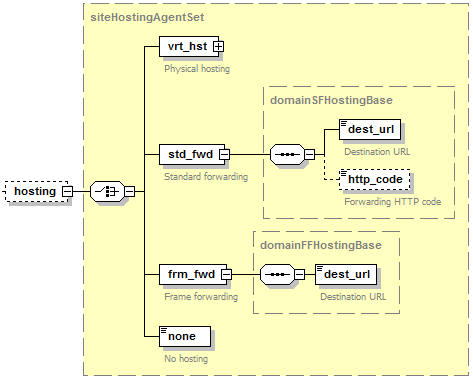

Hosting settings define what type of hosting is provided with a site. They are described by data type siteHostingAgentSet (site.xsd).
The graphical representation of siteHostingAgentSet (site.xsd) is as follows:
image 72663
  • vrt_hst, required
    This node contains virtual hosting settings. See the node definition below.
  • std_fwd, required
    This node contains standard forwarding settings. Data type: domainFFHostingBase (plesk_domain.xsd).
  • frm_fwd, required
    This node contains frame forwarding settings. Data type: domainSFHostingBase (plesk_domain.xsd).
  • The dest_url, required
    It specifies the URL to which users will be redirected at the attempt to visit the specified site. Data type: string.
  • The http_code, required
    It specifies the HTTP code for redirection when you use standard forwarding. Data type: integer.
  • The none, required
    This node is used when a site ships with a site. If specified, hosting settings will be deleted. Data type: none.

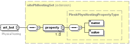

The graphical representation of the vrt_hst node is as follows:
image 66562
  • property, required
    It specifies a hosting parameter. Data type: PleskPhysHostingPropertyType (plesk_domain.xsd).
    Note: You can use domain properties to set up custom PHP configuration for your domain. For this purpose, use the same syntax as for php.ini (the name node should contain the name of a PHP parameter and the value node - its value).
  • name, required
    It specifies a hosting parameter name. Data type: string.
  • value, required
    It specifies a hosting parameter value. Data type: any.
Note: You can specify multiple property parameters in one vrt_hst node.
