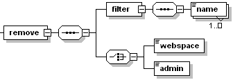

The remove node does not have a separate type, it is nested within type CertificateActionRequest (certificate_input.xsd). The remove node has the following graphical representation:
image 34949
  • The filter, required. It contains rules defining which certificates should be deleted. Data type: none.
  • The name, required. It specifies the name of certificate that should be deleted. Data type: string.
  • The webspace, required. It specifies from which subscription storage the certificate is deleted. Data type: string.
  • The admin, required. It specifies that the certificate is deleted from Administrator’s repository . Data type: none.

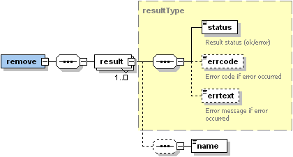

Response Packet Structure
The remove node of the output XML packet is structured as follows:
image 35149
  • The result node is required. It wraps the response retrieved from the server. Data type: resultType (common.xsd).
  • The status node is required. Specifies the execution status of the remove operation. Data type: string. Allowed values: ok | error.
  • The errcode node is optional. It is used to return the error code when the remove operation fails. Data type: unsignedInt.
  • The errtext node is optional. It is used to return the error message if the remove operation fails. Data type: string.
  • The name node is optional. Returns the certificate name if the certificate is not found on the server. Data type: string.
