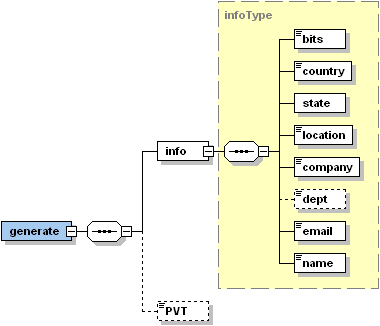

The generate node does not have a separate data type, it is nested in the CertificateActionRequest type (certificate_input.xsd). The node has the following graphical representation:
image 35495
Note
  • The info node is required. It contains the set of parameters required for generating certificate components. Data type: none.
  • The bits node is required. It defines the size of certificate in bits. Data type: integer. Allowed values: 1024 | 2048.
  • The country node is required. It specifies the country where your business operates. Data type: string. Value restrictions: two-letters upper-case country nomination in accordance with ISO 3166.
  • The state node is required. It specifies the state or province where your business operates. Data type: string. Value restrictions: full name of state/ province in lower case (e.g., “california”), or two-letters upper-case indication (e.g., “CA”).
  • The location node is required. It specifies the name of the city where your business operates. Data type: string.
  • The company node is required. It specifies the name of the company with which the certificate will be associated. Data type: string.
  • The dept node is optional. It specifies the company department. Data type: string.
  • The email node is required. It specifies your email address that will be used for generating CSR component of the certificate. Data type: string.
  • The name node is required. It specifies the name of the site with which the certificate should be associated. Data type: string.
  • The PVT node is optional. It defines the private key part of the certificate. Data type: string.

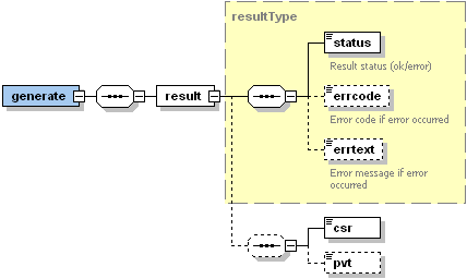

The generate node of the output XML packet is structured as follows:
image 34986
Note
  • The result node is required. It wraps the response retrieved from the server. Data Type: resultType (extension) (common.xsd) .
  • The status node is required. Specifies the execution status of the generate operation. Data type: string. Allowed values: ok | error.
  • The errcode node is optional. Is used to return the error code when the generate operation fails. Data type: unsignedInt.
  • The errtext node is optional. Can be used to return the error message if the generate operation fails. Data type: string.
  • The csr node is required. It contains the CSR component of the generated certificate. Data Type: string.
  • The pvt node is optional. It contains the Private Key component of the generated certificate. Data Type: string.
