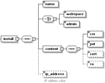

The install node does not have a separate data type, it is nested
within type CertificateActionRequest (certificate_input.xsd). The
install node has the following graphical representation:
name, required
Specifies the name under which the certificate will be known in the repository and in Plesk. Data type: string.
Either the webspace or admin elements are required.
webspace, optional
Specifies the subscription to which the certificate is installed. Data type: string.
admin, optional
Specifies that the certificate is installed to the server repository. Data type: none.
content, required
Contains all data constituting the certificate. Data type: none.
csr, required
Specifies the certificate CSR (certificate signing request). Data type: string.
pvt, required.
Specifies the certificate private key. Data type: string.
cert, optional
Contains the certificate body. Data type: string.
ca, optional
Contains the certificate authority body. Data type: string.
ip_address, optional
Specifies IP address to which the certificate will be assigned when it is installed to server repository. This assignment means that sites hosted on this IP address, in case SSL/TLS support is enabled for them, will display this certificate when accessing the sites. Data type: ip_type (
common.xsd).

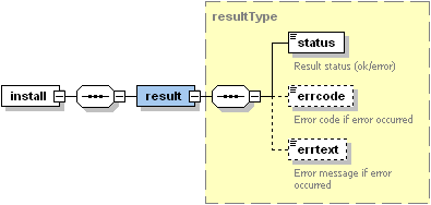

Response Packet Structure
The install node of the output XML packet is structured as follows:
result, required
Wraps the response retrieved from the server.
status, required
Specifies the execution status of the operation. Data type: string. Allowed values: ok | error.
errcode, required if the operation fails
Returns the error code. Data type: unsignedInt.
errtext, required if the operation fails
Returns the error message . Data type: string.
