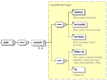

Response Packet Structure
The add node of the output XML packet is of complex type (webspace.xsd) which has the following presentation:
image 72652
  • The result node is optional. It wraps the response got from the server. Data type: resultFilterType (common.xsd).
  • The status node is required. Specifies the execution status of the operation. Data type: string. Allowed values: ok | error.
  • The errcode node is optional. Returns the error code when the operation fails. Data type: unsignedInt.
  • The errtext node is optional. Returns the error message if the operation fails. Data type: string.
  • The filter-id node is optional. Returns the parameter by which the service plan was filtered by in the request packet. Data type: anySimple.
  • The id node is optional. Returns the identifier of the service plan to which the application was added. Data type: id_type (common.xsd).
