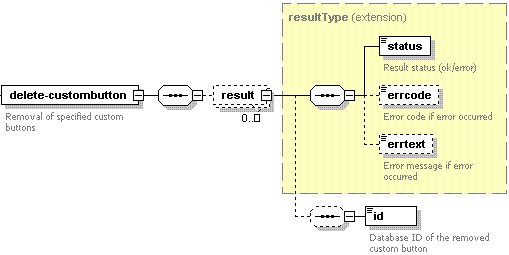

Response Packet Structure
The delete-custombutton node of the output XML packet is structured as follows:
- The result node is required. It wraps the response retrieved
from the server. Data type: resultType (
common.xsd
). - The status node is required. It specifies the execution status of the operation. Data type: string. Allowed values: ok | error.
- The errcode node is optional. Is returns the error code if the operation fails. Data type: integer.
- The errtext node is optional. It returns the error message if the operation fails. Data type: string.
- The id node is optional. If the operation succeeds, it returns the ID of the removed custom button. Data type: integer.
