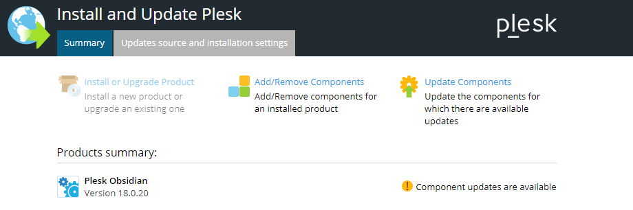

To add or remove Plesk components, go to Tools & Settings > Updates.
When you select Add/Remove Components, you will be asked to provide system user credentials to proceed.
Muista
You need to provide system user credentials, not those used to log in to Plesk. The user in question also must have the necessary permissions to install software. The administrator credentials you use to log in to the server via RDP should work fine here.

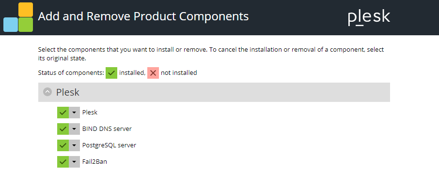

Next, click Add/Remove Components to see a list of all available Plesk components. Some of them are presented individually, and some are grouped by function.
image 74722
The image 74723 icon next to a component indicates that the component is installed, and the image 74724 icon indicates that it is not installed. The image 74725 icon next to a group of components indicates that not all components in the group are installed. Groups with all components installed are marked with the image 74726 icon, and those with no components installed are marked with the image 74727 icon.
image 74732
To mark a component for installation, click the image 74728 icon next to the component’s name > Install. You can mark all components in a group for installation by clicking the image 74729 icon next to the component’s name > Install.
image 74733
To mark a component for removal, click the image 74730 icon next to the component’s name > Remove. You can mark all components in a group for removal by clicking the image 74731 icon next to the component’s name > Remove.
After you have marked all components you want to install or remove, click Continue to begin the installation or removal. To exit the Plesk Installer without making any changes, click Cancel modifying.
