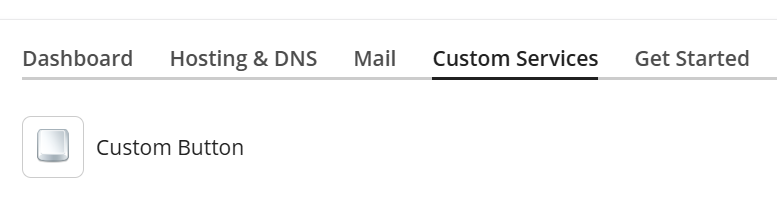

    • Website Tools. The custom button will appear on the Websites & Domains page, on the "Custom Services" tab:
      image button website tools
