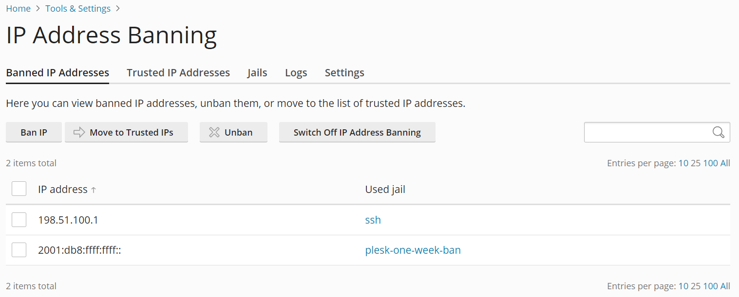

Manually Banning and Unbanning IP Addresses
You can see what IP addresses are currently banned by Fail2Ban. You can also manually issue a ban to an IP address, or unban an IP address that has been banned.
To see the list of currently banned IP addresses:
- 登錄到 Plesk。
- Go to Tools & Settings > IP Address Banning (Fail2Ban) (under 「Security」).
- Go to the 「Banned IP Addresses」 tab.
On this tab, you can see all the IP addresses that are currently banned by Fail2Ban, together with the names of the jails responsible for the ban.
To manually ban one or more IP addresses:
- 登錄到 Plesk。
- Go to the 「Banned IP Addresses」 tab, and then click Ban IP.
- Specify the IP address or the CIDR subnet mask you want to ban under 「IP address」.
- Select the desired ban length under 「Ban the IP address」, and then click OK.
The specified IP address or addresses are now banned. You can see them on the 「Banned IP Addresses」 tab.
You can manually unban an IP address at any time, whether it was banned automatically or manually.
To manually unban one or more IP addresses:
- 登錄到 Plesk。
- Select the IP address or addresses you want to unban from the list of the currently banned IP addresses, and then click Unban.
The selected IP address or addresses are no longer banned.

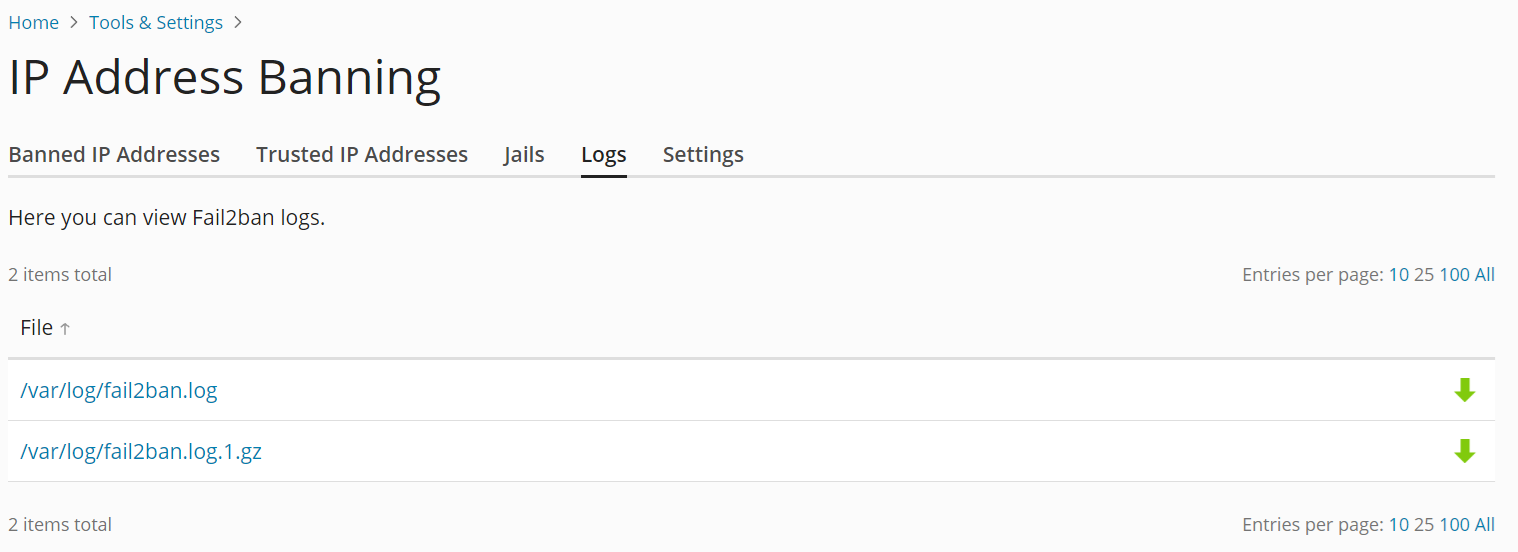

Viewing and Downloading the Fail2Ban Log File
Fail2Ban writes the information about IP addresses being banned and unbanned, as well as other information (such as jails being created or activated) to a log file. You can view Fail2Ban logs from the Plesk graphical interface, and also download them to your computer.
To view or download the Fail2Ban log file:
- 登錄到 Plesk。
- Go to the 「Logs」 tab, and then click a log file to view it.
- (Optional) Click the
icon next to a log file to download it to your computer.
