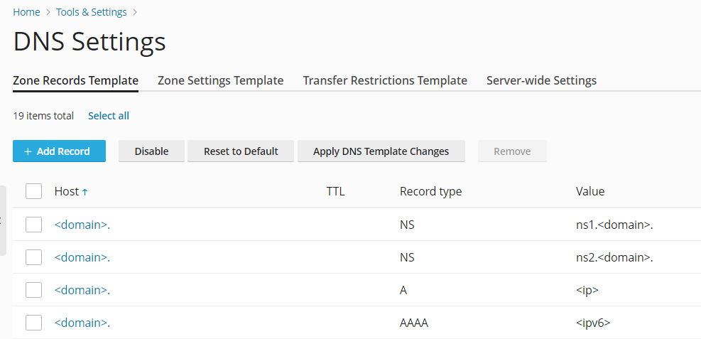

To see the records currently present in the DNS template, go to Tools & Settings > DNS Settings (under 「General Settings」). On the 「Zone Records Template」 tab, you can also add, modify, and remove records:
若要添加記錄,請點按 添加記錄 。若要修改記錄,請按一下其名稱。當添加或修改記錄時 ,您可以使用以下預留位置,這些預留位置可在域名創建時被實際值替換:

若要移除記錄,請選擇記錄名稱旁邊的核取方塊並點按 移除 。注意從範本移除某些記錄將會影響在 Plesk 中創建的域名的功能。例如,移除 A 記錄將會阻止域名進行解析。如果您對影響客戶網站功能的 DNS 範本做了更改,您則可以點按 重設為預設值 來恢復預設的 DNS 範本。

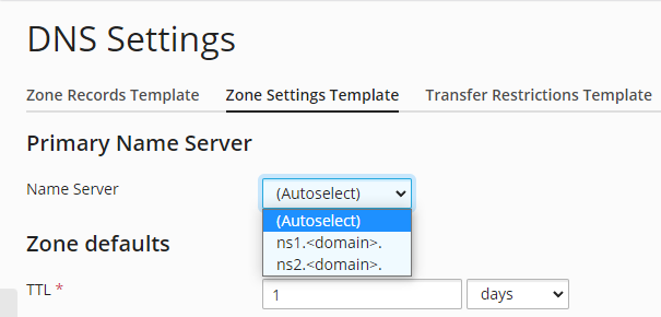

The DNS template also includes the default SOA record. To view and change the SOA record values, go to Tools & Settings > DNS Settings (under 「General Settings」), and then go to the 「Zone Settings Template」 tab.

您可以通過將此域名伺服器指定為域名的主要域名伺服器來顯式指定將用作輔助域名伺服器可信資料來源的域名伺服器。若要實現此目的,請在 「主要域名伺服器」,選擇所需的域名伺服器。

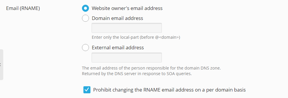

You can also choose the email address of a person responsible for the domain’s DNS zone (so called RNAME email address) in Tools & Settings > DNS Settings (under 「General Settings」). The selected option will be applied to all domains in Plesk. However, the RNAME email address still can be changed for each domain. To prohibit changing the RNAME email address on a per domain basis, select the corresponding checkbox.
