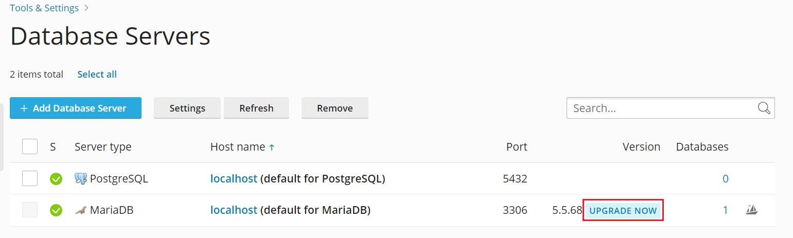

  1. 進入 工具與設定 > 資料庫伺服器 (在」應用程式與資料庫」下)。
  2. Click UPGRADE NOW corresponding to the row with the MariaDB database server.
    image mariadb upgrade button

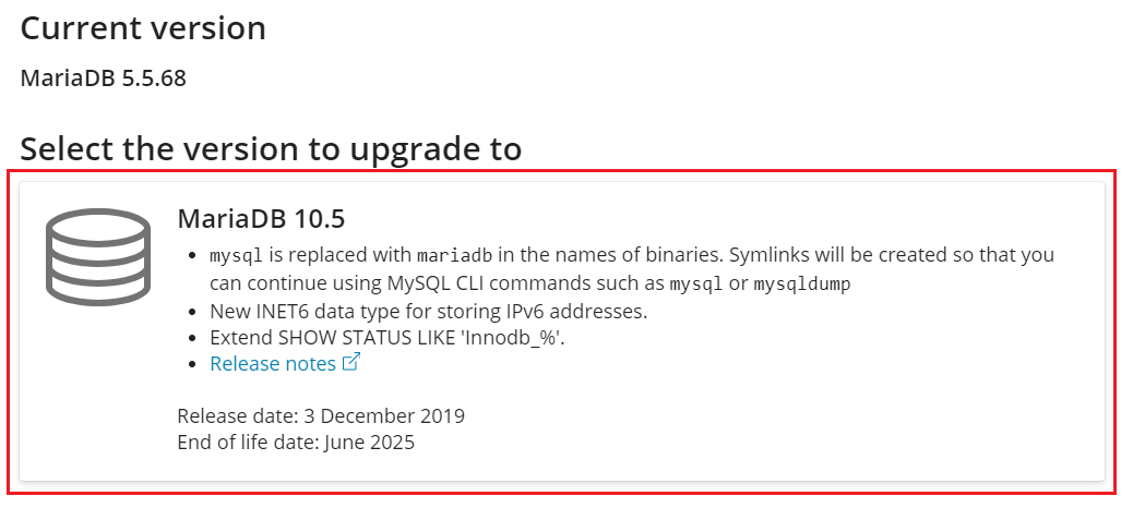

  3. Click the MariaDB version Plesk offers upgrading to.
    image mariadb upgrade 1
    Plesk will start pre-upgrade checks. Once they are finished, you will see the suggested safety measures that will help you to recover your databases if anything goes wrong with the upgrade.
