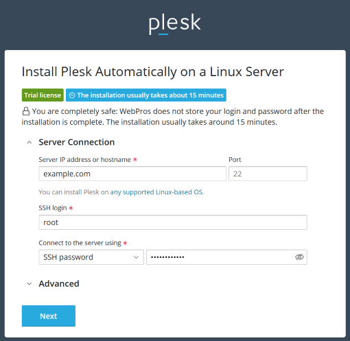

  5. Use the Plesk Web Installer to install Plesk on your server. Specify the following settings:
    • Server IP address or hostname. Specify your server’s Internet address.
    • SSH login. Specify your server’s SSH login.
    • Connect to the server using. Select the authentication method you want to use to connect to the server: password or SSH key.
    image 77117
  6. Click Next.
