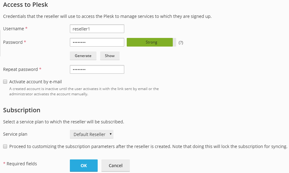

If you do not use billing automation, then to start serving a reseller in Plesk, you should create a reseller account and subscribe it to a reseller plan.
To subscribe a new reseller to a reseller plan:
  1. Go to Resellers, and click Add Reseller.
    newreseller
  2. Specify the reseller contact/billing information, user name and password.
  3. You can add some notes, or a description, to a reseller account. This description will be displayed in the list of resellers. Only you as an owner of a reseller account will be able to view this description.
  4. Select a reseller plan with which the subscription should be associated.
  5. Leave the Proceed to customizing the subscription checkbox cleared.
  6. Click OK.
