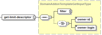

The get-limit-descriptor node is presented by type DomainAddonTemplateGetInputType (domain_addon_template.xsd). Its graphical representation is as follows:
image 68365
Note
Note
When creating request packets, put nodes and elements in the order they follow in the packet structure.

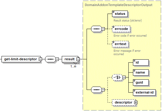

Response Packet Structure
The get-limit-descriptor node of the output XML packet is of type DomainAddonTemplateDescriptorOutput (domain_addon_template.xsd) which is structured as follows:
image 68413
Note
  • The result node is required. It wraps the result of the requested get-limit-descriptor operation. Data type: ResultFilterType (common.xsd).
  • The status node is required. It returns the execution status of the get-limit-descriptor operation. Data type: result_status (common.xsd). Allowed values: ok|error.
  • The errcode node is optional. Is used to return the error code when the get-limit-descriptor operation fails. Data type: unsignedInt.
  • The errtext node is optional. Can be used to return an error message if the get-limit-descriptor operation fails. Data type: string.
  • The id node is optional. It is required if the operation succeeds and the results are filtered by ID. It returns an ID of the add-on plan which limits descriptor was displayed. Data type: id_type (common.xsd).
  • The name node is optional. It is required if the operation succeeds and the results are filtered by name. It returns a name of the add-on plan which limits descriptor was displayed. Data type: string (common.xsd).
  • The guid node is optional. It is required if the operation succeeds and the results are filtered by GUID. It returns a GUID of the add-on plan which limits descriptor was displayed. Data type: string (common.xsd).
  • The external-id node is optional. It is required if the operation succeeds and the results are filtered by external ID. It returns the external ID of the add-on plan which limits descriptor was displayed. Data type: string (common.xsd).
  • The descriptor node is required if the get-limit-descriptor operation succeeds. It specifies object descriptor. For details, refer to the Representation of Object Descriptors section. Data type: string.
