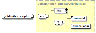

The get-limit-descriptor node is presented by type
DomainAddonTemplateGetInputType (domain_addon_template.xsd). Its
graphical representation is as follows:

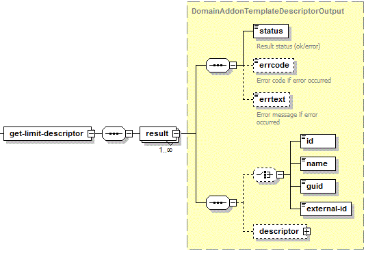

Response Packet Structure
The get-limit-descriptor node of the output XML packet is of type
DomainAddonTemplateDescriptorOutput (domain_addon_template.xsd)
which is structured as follows:
The result node is required. It wraps the result of the requested get-limit-descriptor operation. Data type: ResultFilterType (
common.xsd). -
The status node is required. It returns the execution status of the get-limit-descriptor operation. Data type: result_status (
common.xsd). Allowed values:ok|error. -
The errcode node is optional. Is used to return the error code when the get-limit-descriptor operation fails. Data type: unsignedInt.
The errtext node is optional. Can be used to return an error message if the get-limit-descriptor operation fails. Data type: string.
The id node is optional. It is required if the operation succeeds and the results are filtered by ID. It returns an ID of the add-on plan which limits descriptor was displayed. Data type: id_type (
common.xsd). -
The name node is optional. It is required if the operation succeeds and the results are filtered by name. It returns a name of the add-on plan which limits descriptor was displayed. Data type: string (
common.xsd). -
The guid node is optional. It is required if the operation succeeds and the results are filtered by GUID. It returns a GUID of the add-on plan which limits descriptor was displayed. Data type: string (
common.xsd). -
The external-id node is optional. It is required if the operation succeeds and the results are filtered by external ID. It returns the external ID of the add-on plan which limits descriptor was displayed. Data type: string (
common.xsd). -
The descriptor node is required if the get-limit-descriptor operation succeeds. It specifies object descriptor. For details, refer to the Representation of Object Descriptors section. Data type: string.
Note: This descriptor contains limits extensions. For details, refer to the Representation of Object Descriptors: Property Descriptor > Extension of Limits Descriptor section.
