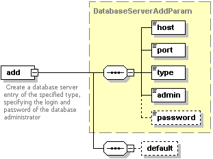

The add node is presented by type DatabaseServerAddParam
(plesk_db.xsd), and its graphical representation is as follows:
- The host node is required. It specifies the IP address or name of the database server you want to add. Data type: string.
- The port node is required. It specifies the port of the database server. Data type: string.
- The type node is required. It specifies the database server type. Data type: string. Allowed values: mysql | postgresql | mssql.
- The admin node is required. It specifies the login name of administrator of the database server. Data type: integer.
- The password node is optional. It specifies the password of administrator of the database server. Data type: integer.
- The default node is optional. It specifies if the database server manages the databases of a certain type (defined by type). Data type: none.

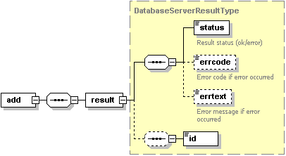

The add node of the output XML packet is structured as follows:
- The result node is required. It wraps the response retrieved
from the server. Data type: DatabaseServerResultType
database_output.xsd). - The status node is required. It specifies the execution status of the add operation. Data type: string. Allowed values: ok | error.
- The errcode node is optional. Is returns the error code if the add operation fails. Data type: integer.
- The errtext node is optional. It returns the error message if the add operation fails. Data type: string.
- The id node is optional. If the add operation succeeds, it returns the ID of the database server. Data type: integer.
