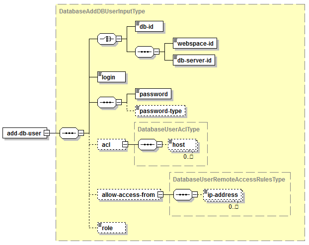

The add-db-user node is presented by type DatabaseAddDBUserInputType (database_input.xsd), and its graphical representation is as follows:
image 72559
  • The db-id node is required. It specifies the ID of the database where a new user will be created. Data type: integer.
  • The webspace-id node is required. It specifies ID of the subscription where a new database user will be created. Used to create a universal user with access to all databases within the specified subscription. Data type: integer.
  • The db-server-id node is required. It specifies ID of the database server to which a new user will be assigned. Used to create a universal user with access to all databases within the specified database server. Data type: integer.
  • The login node is required. It specifies login name of the database user. Data type: string.
  • The password node is required. It specifies the password of the database user. Data type: string (length should be more than five digits).
  • The password-type node is optional. Specifies if it is plain or encrypted password. Data type: string. Allowed values: plain | crypt.
  • The acl node is optional. It specifies the hosts from which a database user is allowed to connect to a database. Data type: DatabaseUserAclType, which consists of host elements of the string data type.
  • The allow-access-from node is optional. It specifies the IP addresses from which access to a database is allowed. Data type: DatabaseUserRemoteAccessRulesType, which consists of ip-address elements of the string data type.
  • The role node is optional. Specifies the database user role. Data type: string. Allowed values: readWrite, readOnly, writeOnly.

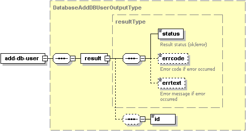

Response Packet Structure
The add-db-user node of the output XML packet is presented by type DatabaseAddDBUserOutputType (database_output.xsd) and structured as follows:
image 37566
  • The result node is required. It wraps the response retrieved from the server. Data type: resultType (common.xsd).
  • The status node is required. It specifies the execution status of the add-db–user operation. Data type: string. Allowed values: ok | error.
  • The errcode node is optional. Is returns the error code if the add-db–user operation fails. Data type: integer.
  • The errtext node is optional. It returns the error message if the add-db–user operation fails. Data type: string.
  • The id node is required. It specifies the database user ID. Data type: integer.
