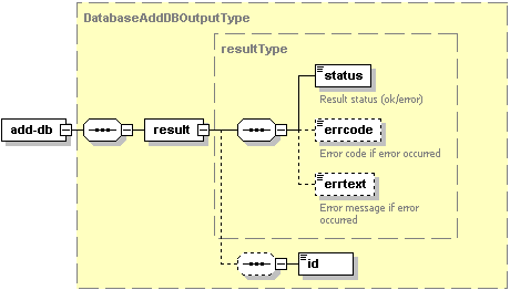

Response Packet Structure
The add-db node of the output XML packet is presented by type
DatabaseAddDBOutputType (database_output.xsd
) and structured as
follows:
- The result node is required. It wraps the response retrieved
from the server. Data type: resultType (
common.xsd
). - The status node is required. It specifies the execution status of the add-db operation. Data type: string. Allowed values: ok | error.
- The errcode node is optional. Is returns the error code if the add-db operation fails. Data type: integer.
- The errtext node is optional. It returns the error message if the add-db operation fails. Data type: string.
- The id node is optional. If the add-db operation succeeds, it returns the ID of the database. Data type: integer.
