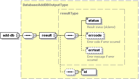

The add-db node of the output XML packet is presented by type DatabaseAddDBOutputType (database_output.xsd) and structured as follows:
image 37557
  • The result node is required. It wraps the response retrieved from the server. Data type: resultType (common.xsd).
  • The status node is required. It specifies the execution status of the add-db operation. Data type: string. Allowed values: ok | error.
  • The errcode node is optional. Is returns the error code if the add-db operation fails. Data type: integer.
  • The errtext node is optional. It returns the error message if the add-db operation fails. Data type: string.
  • The id node is optional. If the add-db operation succeeds, it returns the ID of the database. Data type: integer.
