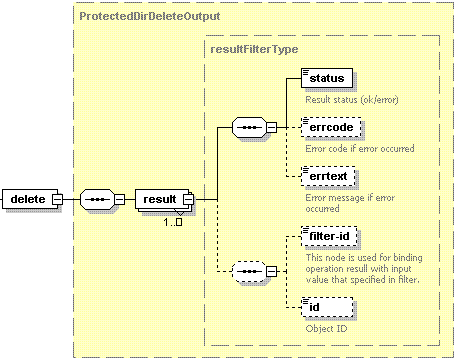

Response Packet Structure
The delete node of the output XML packet is presented by type ProtectedDirDeleteOutput (protected_dir.xsd) and structured as follows:
Note
  • The result node is required. It wraps the response retrieved from the server. Data type: resultFilterType (common.xsd).
  • The status node is required. It specifies the execution status of the operation. Data type: string. Allowed values: ok | error.
  • The errcode node is optional. Is returns the error code if the operation fails. Data type: integer.
  • The errtext node is optional. It returns the error message if the operation fails. Data type: string.
  • The filter-id node is required if the request packet is valid . It returns the filtering rule parameter. For details, refer to the Available Filters section. Data type: anySimple.
  • The id node is required if the operation succeeds . It returns the ID of the removed protected directory. Data type: integer.
