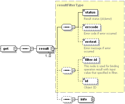

Response Packet Structure
The get node of the output XML packet is structured as follows:
- The result node is required. It wraps the response received
from the server. Data type: resultFilterType (
common.xsd
Note: The node is required. Specifies the execution status of the get operation. Data type: string. Allowed values: ok | error.
- The errcode node is optional. Is used to return the error code when the get operation fails. Data type: unsignedInt.
- The errtext node is optional. Can be used to return the error message if the get operation fails. Data type: string.
- The id node is optional. It returns the site alias id; it is required if the get operation has succeeded or if this id was specified in the request packet. Data type: integer.
- The filter-id node is optional. It returns a filtering rule parameter. For more information, refer to the Available Filters section. Data type: anySimple.
- The info node is optional. It is present if the get
operation succeeds and contains the alias preferences. For more
information, refer to the Site Alias Settings
section. Data type: AliasInfoType (
plesk_domainalias.xsd
