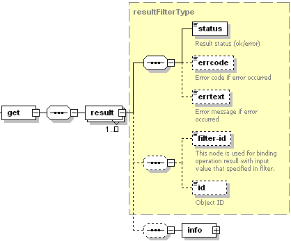

Response Packet Structure
The get node of the output XML packet is structured as follows:
  • The result node is required. It wraps the response received from the server. Data type: resultFilterType (common.xsd).
Note: The node is required. Specifies the execution status of the get operation. Data type: string. Allowed values: ok | error.
  • The errcode node is optional. Is used to return the error code when the get operation fails. Data type: unsignedInt.
  • The errtext node is optional. Can be used to return the error message if the get operation fails. Data type: string.
  • The id node is optional. It returns the site alias id; it is required if the get operation has succeeded or if this id was specified in the request packet. Data type: integer.
  • The filter-id node is optional. It returns a filtering rule parameter. For more information, refer to the Available Filters section. Data type: anySimple.
  • The info node is optional. It is present if the get operation succeeds and contains the alias preferences. For more information, refer to the Site Alias Settings section. Data type: AliasInfoType (plesk_domainalias.xsd) .
