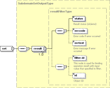

Response Packet Structure
The set node of the output XML packet is structured as follows:
The result node is required. It wraps the response retrieved from the server. Data type: ResultFilterType (
common.xsd).The status node is required. It specifies the execution status of the get operation. Data type: result_status (
common.xsd). Allowed values:ok|error.The errcode node is required if the set operation fails. It returns the error code. Data type: unsignedInt.
The errtext node is required if the set operation fails. It returns the error message. Data type: string.
The filter-id node is required if the set operation succeeds. It returns the parameter by which the subdomain was filtered in the request packet. Data type: anySimple.
The id node is required if the set operation succeeds. It returns the ID of the subdomain which settings are retrieved in the response packet. Data type: id_type (
common.xsd).
