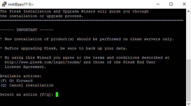

image 76796
Read the text marked with “IMPORTANT”, then type the character F and press the Enter key to proceed.

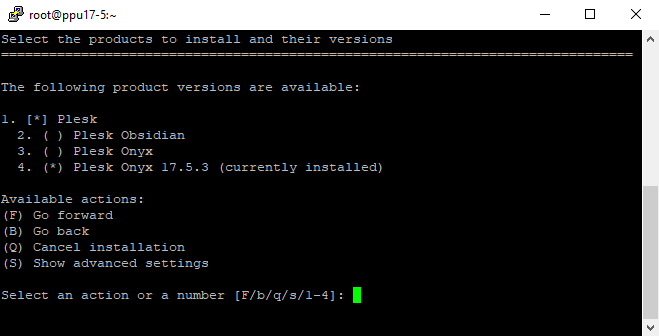

image 77329
Next, you need to select to which version of Plesk you want to upgrade. Here you are about to upgrade to the latest Plesk release.
image 77330

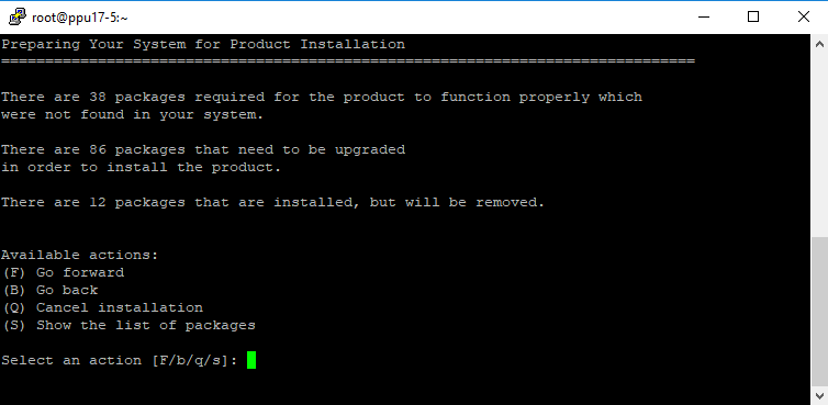

Type F and press Enter to continue. Plesk installer will download the installation files for the selected Plesk version and prompt you for confirmation.
image 76799
Type F and press the Enter key to begin the upgrade.
