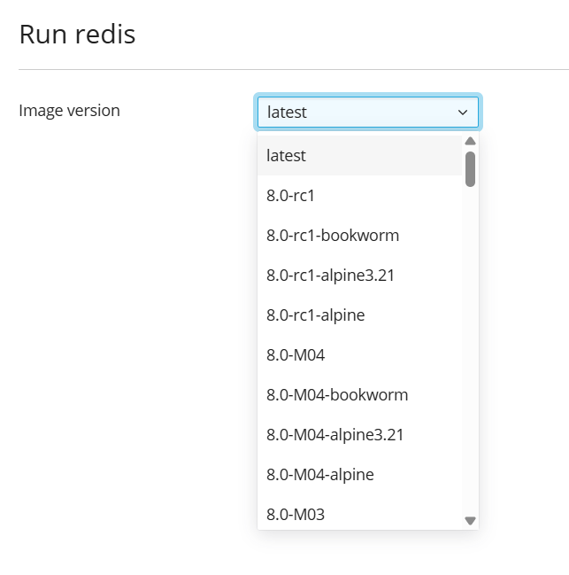

Multiple versions may be available for each application. You can run a specific version by selecting the appropriate tag, as shown below:
image docker catalog version
若要运行容器:
  1. Go to Docker > Containers > Run Container.
  2. Use the search box to find images in the catalog. If the image is stored locally, (local) appears after the version.
  3. To view the image description and documentation on Docker Hub, click the more info icon image expand icon. This does not apply to local images.
  4. Click the image card.
    • To run a specific version, select the image version you want to run from the Image version drop-down and click Next.
    • To run the latest version of the selected application, click Next.

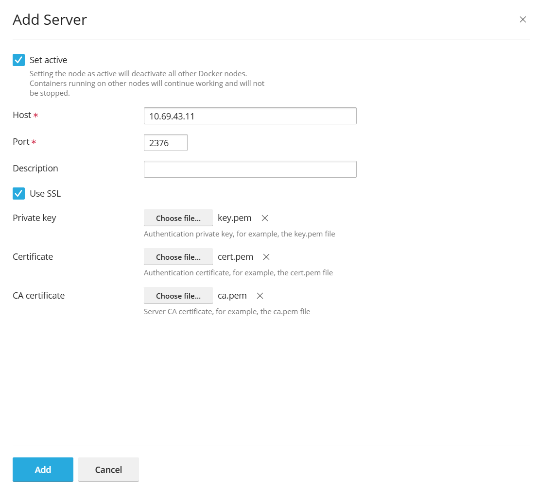

You can establish a connection between a Plesk server with the Docker extension and a remote node with Docker service.
以下步骤同时适用于 Plesk for Linux 和 Plesk for Windows。
These steps must be performed on the remote host:
#. Create the /etc/docker/daemon.json configuration file for Docker with the following content:
1 {
2   "hosts": ["tcp://0.0.0.0:2376", "unix:///var/run/docker.sock"],
3   "tls": true,
4   "tlsverify": true,
5   "tlscacert": "/root/ca.pem",
6   "tlscert": "/root/server-cert.pem",
7   "tlskey": "/root/server-key.pem"
8 }
#. Prepare .pem files. You can use the following example. Replace the IP on line 4 with the IP address of your remote node and run each command:
 1 openssl genrsa -aes256 -out ca-key.pem 4096
 2 openssl req -new -x509 -days 365 -key ca-key.pem -sha256 -out ca.pem
 3 openssl genrsa -out server-key.pem 4096
 4 openssl req -subj "/CN=192.0.2.1" -new -key server-key.pem -out server.csr
 5 openssl x509 -req -days 365 -sha256 -in server.csr -CA ca.pem -CAkey ca-key.pem -CAcreateserial -out server-cert.pem
 6 openssl genrsa -out key.pem 4096
 7 openssl req -subj '/CN=client' -new -key key.pem -out client.csr
 8 openssl x509 -req -days 365 -sha256 -in client.csr -CA ca.pem -CAkey ca-key.pem -CAcreateserial -out cert.pem
 9 chmod 0400 ca-key.pem server-key.pem key.pem
10 chmod 0444 ca.pem server-cert.pem cert.pem
  1. Run the following commands to modify the current Docker service so it starts after host configuration:
1 cp /lib/systemd/system/docker.service /etc/systemd/system/
2 sed -i 's/\ -H\ fd:\/\///g' /etc/systemd/system/docker.service
3 systemctl daemon-reload
4 systemctl restart docker
  1. Save the outputs of the following files on your local machine for use by the client to connect remotely:
1 cat key.pem
2 cat cert.pem
3 cat ca.pem
On the local server, configure the Docker remote host:
  1. Go to Docker > Environments.
  2. Click Add Server image plus icon and specify the settings of the remote server with Docker.
  3. 若要开始在 Plesk 中使用该 Docker,请选定 设为活动 选项。
image docker add remote node
The link to Docker will appear in the Navigation Pane.
若要在 Docker 服务之间切换:
  2. In the list of servers, select the Docker node that you are going to use and click Set Active.
Alternatively, you can set the Docker node as active while editing its settings.

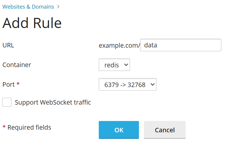

You can set up nginx to proxy requests from domains to that port, so domains can use a standard port on nginx (for example, 80). To make this possible, add a rule for nginx in the domain settings.
To add a rule for nginx in the domain settings:
进入 网站与域名 > 域名> Docker 代理规则* > 添加规则 并指定以下项:
  • URL 。指定使用在容器中运行的应用的网站的 URL。可以是主网站也可以是其中一部分。
  • 容器 。选择以 Docker 容器形式运行的应用。
  • 端口 。选择在容器设置中指定的某个映射(某个容器内的一个端口映射到您的系统上的一个端口)。Nginx 将会代理到系统上该端口的请求。
image docker nginx rule
代理规则在web服务器配置中实现,例如在网站的  nginx.conf 文件中(在 /var/www/vhosts/system/$domain/conf/ 目录中):
#extension docker begin
location ~ ^/.* {
    proxy_pass http://0.0.0.0:9080;
    proxy_set_header Host             $host;
    proxy_set_header X-Real-IP        $remote_addr;
    proxy_set_header X-Forwarded-For  $proxy_add_x_forwarded_for;
#extension docker end
代理规则在NAT后的服务器上应运行良好。
