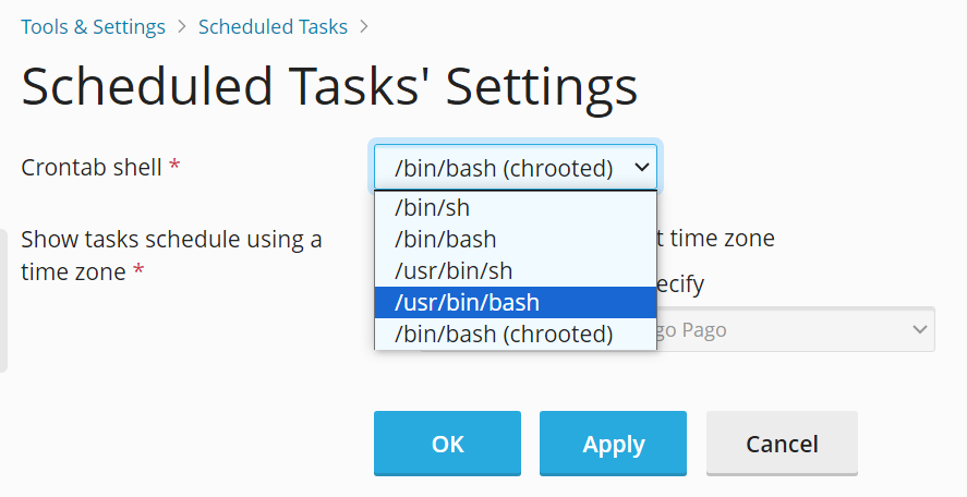

為計畫任務設定默認的 shell
To set the shell that will be used to run all 「Run a Command」 scheduled tasks by default, go to Tools & Settings > Scheduled Tasks (Cron jobs) (under 「Tools & Resources」) > Settings and select the desired shell from the menu.
此外,您可以通過 ssh 登入伺服器並運行以下命令:
plesk bin server_pref -u -crontab-secure-shell "<shell>"
其中 <shell> 是所需的 shell。例如:
plesk bin server_pref -u -crontab-secure-shell "/bin/bash"
