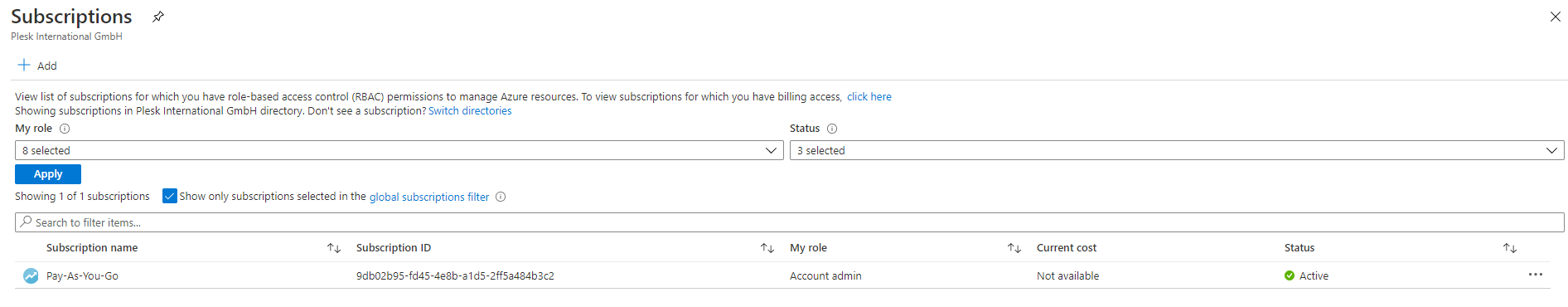

Step 2 - Creating an Azure subscription (if you do not have one)
Log in to the Azure dashboard using your account.
To set up Azure DNS, you need to have an Azure subscription first. Go to Subscriptions and see if you have one.
If you have a subscription, go to Step 3 - Enabling “Microsoft.Network” resource provider. If you do not have one, start creating a subscription by clicking Add.
On the “Pay-As-You-Go” card, click Select offer.
Fill in your profile and payment information, choose a technical support plan (if you need one), select the agreement checkbox and then click Sign up.
You have created a subscription.

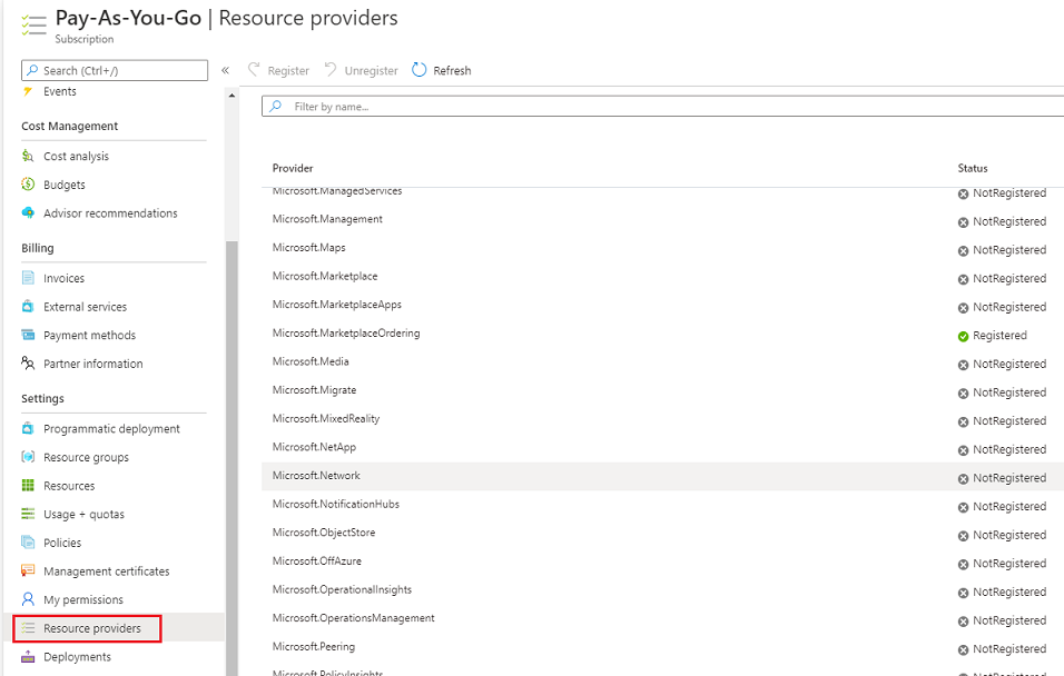

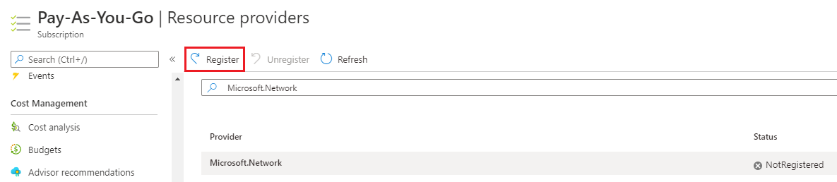

Click the subscription name and then click Resource providers.
Find the “Microsoft.Network” resource provider in the list and make sure that it has the “Registered” status. If it does not, select “Microsoft.Network” and then click Register.
When “Microsoft.Network” is shown as “Registered”, go to the next step.
Note: If you have any issues with registering “Microsoft.Network”, refer to this article.

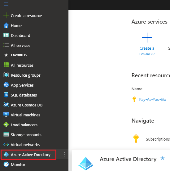

Step 4 - Creating an application
Click the hamburger menu button in the top left corner of the screen and then click Azure Active Directory.

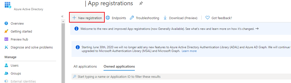

Click App registrations and then click New registration.
Specify the application information:
- A name, for example, “Plesk DNS”.
- Keep the first option “Accounts in this organizational directory only” selected.
- Under “Redirect URI (optional)”, keep “Web” selected.
Return to the Plesk tab where the Azure DNS extension is opened and copy the link shown there.
Return to the Azure tab. Under “Redirect URI (optional)”, paste the link next to “Web”, and then click Register.
You have created an application. Copy “Application (client) ID” and “Directory (tenant ID)” and paste them into the corresponding fields on the Azure DNS extension page.

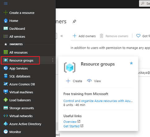

Step 6 - Creating a resource group
Click the hamburger menu button in the top left corner of the screen, click Resource groups, and then click Create resource group (if you do not have any) or Add (if you have one).
Give the resource group a name, select your region, click Review + create, and then click Create.
Once the resource group is created, paste its name into the corresponding field on the Azure DNS extension page.

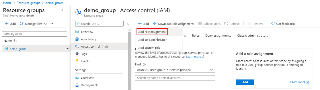

Step 7 - Adding a role assignment
Click the name of the created resource group, click Access control (IAM), and then click Add > Add role assignment.
Specify the role assignment settings and then click Save:
- Under “Role”, select “DNS zone contributor”.
- Keep “Assign access to” empty.
- Under “Select” type and select the name of the created application (“Plesk DNS” in our example).
