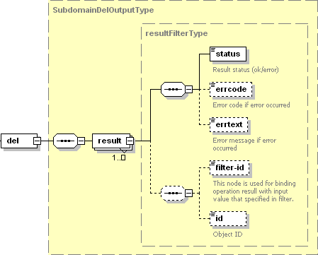

Response Packet Structure
The del node of the output XML packet is structured as follows:
image 53553
  • The result node is required. It wraps the response retrieved from the server. Data type: resultFilterType (common.xsd).
  • The status node is required. It specifies the execution status of the operation. Data type: result_status (common.xsd). Allowed values: ok|error.
  • The errcode node is required if the del operation fails. It is used to return the error code. Data type: unsignedInt.
  • The errtext node is required if the del operation fails. It is used to return the error message. Data type: string.
  • The filter-id node is required if the del operation succeeds . It returns the filtering rule parameter. For details, refer to the Available Filters section. Data type: anySimple.
  • The id node is required if the del operation succeeds. It returns the ID of a deleted subdomain. Data type: id_type (common.xsd) .
