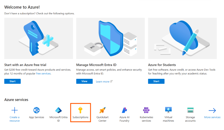

Step 2 - Creating an Azure subscription (if you do not have one)
  1. Log in to the Azure dashboard using your account.

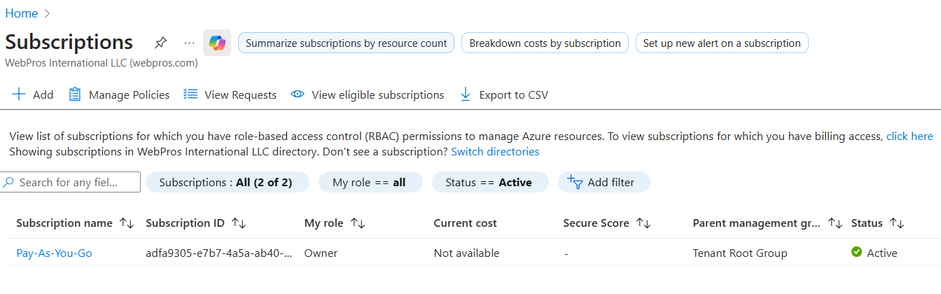

  2. To set up Azure DNS, you need to have an Azure subscription first. Go to Subscriptions and see if you have one.
    image azure 1
    If you have a subscription, go to Step 3 - Enabling “Microsoft.Network” resource provider. If you do not have one, start creating a subscription by clicking Add.
  3. On the “Pay-As-You-Go” card, click Select offer.
  4. Fill in your profile and payment information, choose a technical support plan (if you need one), select the agreement checkbox and then click Sign up.
You have created a subscription.

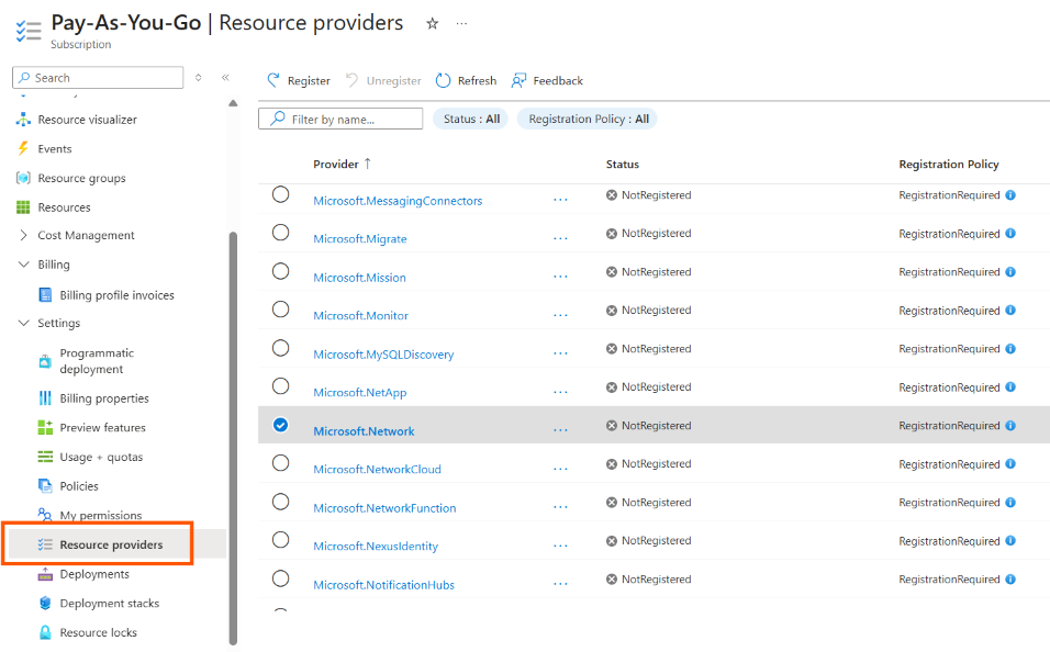

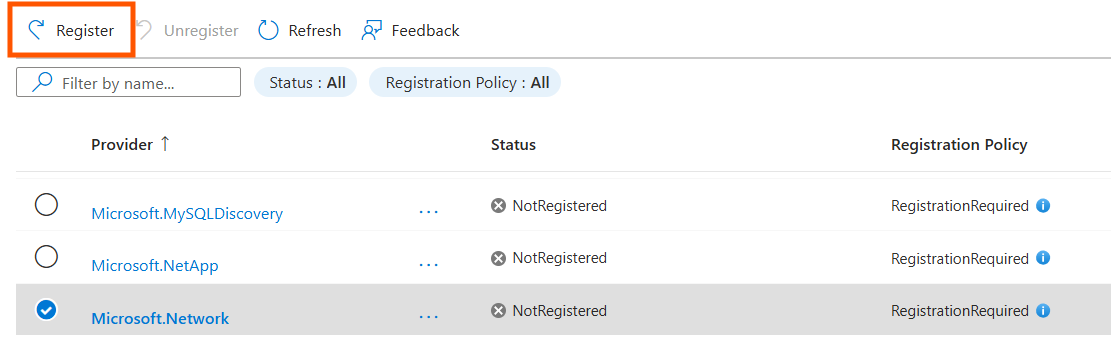

  1. Click the subscription name and then click Resource providers.
    image azure 3
  2. Find the “Microsoft.Network” resource provider in the list and make sure that it has the “Registered” status. If it does not, select “Microsoft.Network” and then click Register.
    image azure 4
When “Microsoft.Network” is shown as “Registered”, go to the next step.

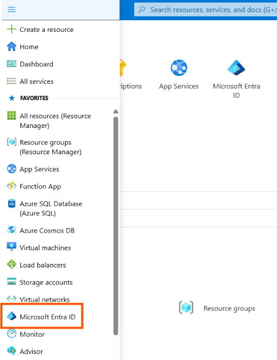

  1. Click the hamburger menu button in the top left corner of the screen and then click Microsoft Entra ID.
    image azure 5

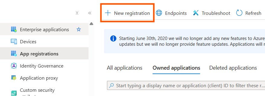

  2. Click App registrations and then click New registration.
    image azure 6

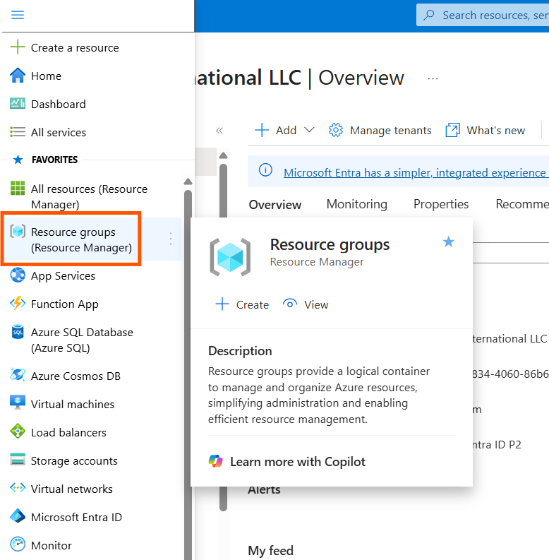

Step 6 - Creating a resource group
  1. Click the hamburger menu button in the top left corner of the screen, click Resource groups, and then click Create resource group (if you do not have any) or Add (if you have one).
    image azure 13
  2. Give the resource group a name, select your region, click Review + create, and then click Create.
    image azure 14
  3. Once the resource group is created, paste its name into the corresponding field on the Azure DNS extension page.

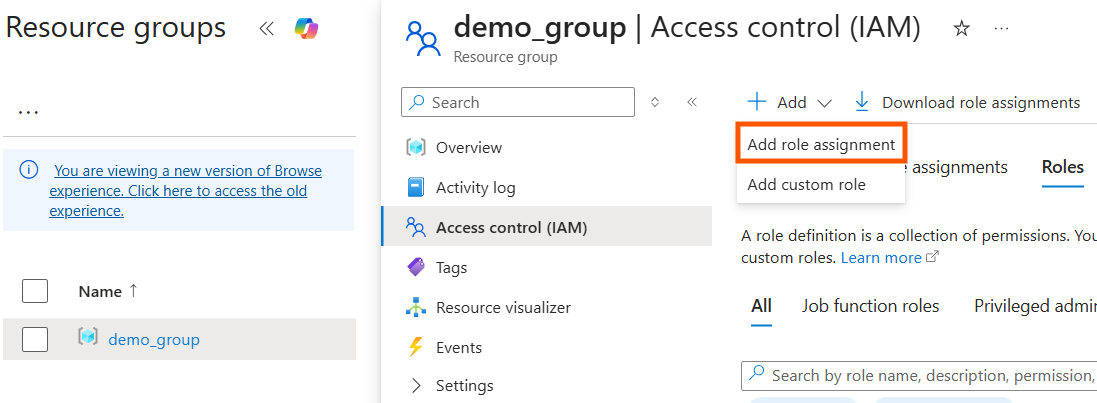

  1. Click the name of the created resource group, click Access control (IAM), and then click Add > Add role assignment.
    image azure 15

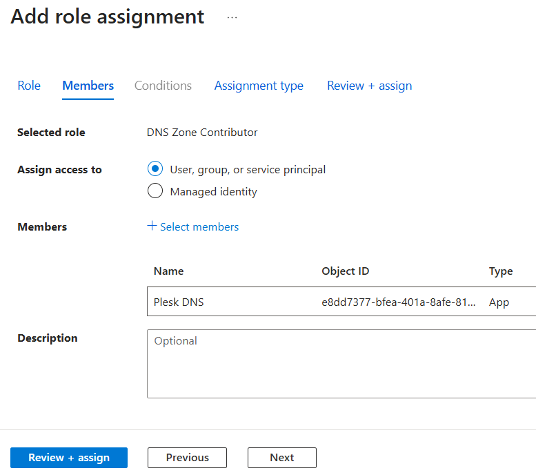

  2. Specify the role assignment settings and then click Save:
    • Under “Role”, select “DNS zone contributor”.
    • For “Assign access to” choose User, group, or service principal.
    • Click “Select members” and select the name of the created application (“Plesk DNS” in our example).
    image azure 16
