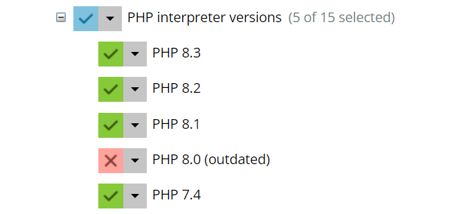

  2. Here, currently installed PHP versions are marked with a green checkbox icon, and those currently not installed with a red cross icon. Select the PHP versions you want to install by clicking the corresponding icon > Install. Select the PHP versions you want to remove by clicking the corresponding icon > Remove. On the screenshot below, PHP versions 8.3, 8.2, 8.1, and 7.4 are marked for installation, while PHP version 8.0 - for removal.
    image php versions
