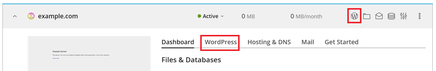

Once the extension is installed, you are ready to begin. You will see the WordPress option in the Navigation Pane
image wordpress menu
and also on the cards of domains with WordPress installed
image wordpress domain card

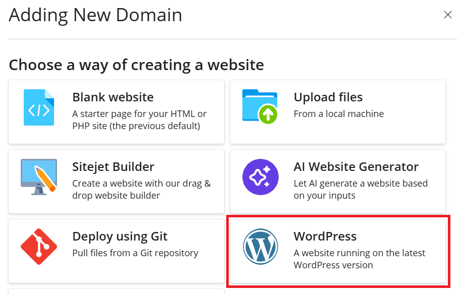

The 「WordPress」 option will also appear in domains』 Create Website drawers.
image wordpress add new website

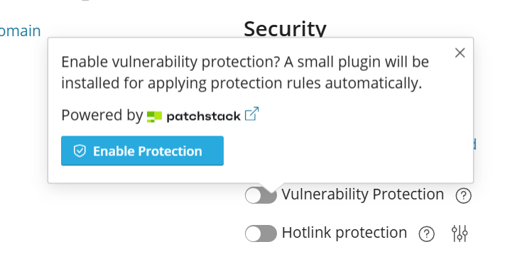

In the 「Security」 section, you can do the following:
  • 查看 SSL/TLS 支持是否已啟用,若未啟用,請 將其啟用。
  • 查看您的網站有多安全以及 提升其安全性。
  • Enable hotlink protection to prevent other websites from displaying, linking or embedding your images. This is called hotlinking and it can quickly drain your bandwidth and make your website unavailable.
image security

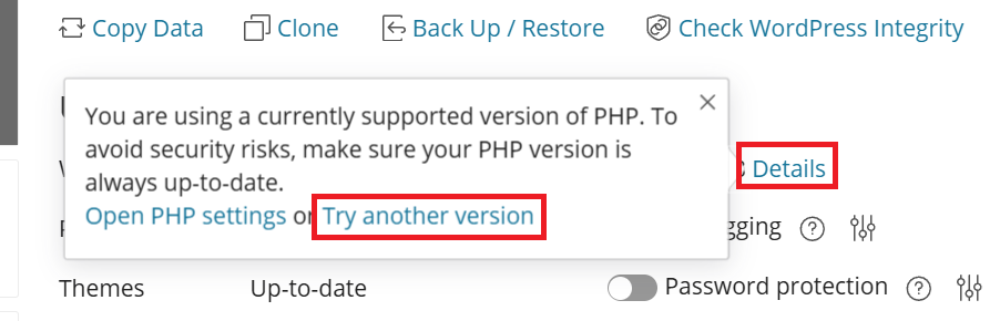

  1. Log in to Plesk.
  2. Go to WordPress, and then find the desired WordPress website.
  3. Under 「Tools」, next to 「PHP」, click Details, and then click Try another version.
    image php smart updates try another

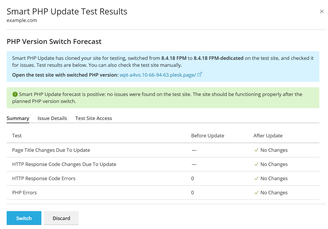

  4. Select the desired PHP version, and then click Check.
WP Toolkit will create a copy of the website and test it using the selected PHP version. This may take a few minutes. Once the process is complete, you will see a report page with the test results.
image smart php update
備註: You can close the report window with no issue. Once a report has been generated, you can return to it later by clicking Details > Review Smart PHP Update results.

  • Vulnerabilities can also be mitigated using the 「Vulnerability Protection」 WP Toolkit feature. It offers a number of advantages compared to the other methods:
    • Vulnerabilities are mitigated automatically as soon as a fix from the PatchStack team is available.
    • There is no need to deactivate vulnerable plugins.

若要驗證 WordPress 安裝實例的校驗和,請執行以下操作:
  1. 轉到 WordPress。
  2. 在所需網站的形式下,按一下“檢查 WordPress 完整性”。
  3. 在出現的快顯視窗中,按一下“驗證校驗和”。
  4. 在 WP Toolkit 驗證校驗和後,請執行以下操作之一:
    • 如果已成功驗證 WordPress 核心檔,請按一下“關閉”。
    • 如果某些核心檔不同,請按一下“重新安裝 WordPress 核心:
      備註: 重新安裝 WordPress 核心並不影響網站內容。但是,我們建議您為網站檔創建備份,作為一種防護措施。
      重新安裝核心檔後,關閉快顯視窗。
因此,將會檢查和保護 WordPress 安裝實例的核心檔。

Securing a Website With the Vulnerability Protection Feature
To secure a WordPress website with the Vulnerability Protection feature:
  1. Log in to Plesk.
  2. Go to WordPress, and then find the WordPress website you want to secure.
  3. Click the 「Vulnerability Protection」 toggle button so that it shows 「Enabled」, and then click Enable Protection.
image enable vulnerability protection
The website is now secured with the Vulnerability Protection feature.
