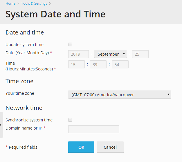

To set the date and time on a Plesk server manually:
  1. Log in to Plesk.
  2. 进入 工具与设置 > 系统时间(在 “常规设置”下)。
  3. Select the “Update system time” checkbox.
  4. Set the date and time to the desired values. You can also select your time zone.
  5. (Plesk for Windows) 如果您不希望 Plesk 自动调整服务器时钟,可清空“自动调整夏令时时钟更改” 复选框。
  6. 单击 保存 。
The changes to the server date, time, and time zone take effect immediately.

(Plesk for Windows) To set up automatic synchronization with a custom NTP server:
  1. Log in to Plesk.
  3. Select the “Synchronize system time” checkbox.
  4. Enter the hostname or IP address of a valid NTP server into the “Domain name or IP” field.
    备注
    If you do not know what NTP server to use, you can specify one of the NTP Pool Project servers. Namely, “0.pool.ntp.org”, “1.pool.ntp.org”, “2.pool.ntp.org”, or “3.pool.ntp.org”.
    image windows set ntp
  5. 单击 保存 。
The date and time on the server will now be synchronized with the specified NTP server every hour. This will override any manual changes to the date and time you may have made.
